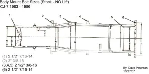

Just replaced the body mounts and the ones in the toe kick area (2) have a smaller hole than the others. Did a search and saw a couple other people had this problem also and had to get a poly mount kit that had the right size bushing and sleeve. I have a 78 CJ7 and went with a rubber kit. Anyone could tell me what the deal is with this and what mount will fit? Or, am I gonna have to drill the frame hole out? Thanks!
