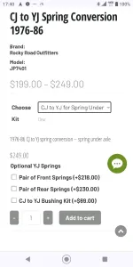

Title says it all. Well sorta. I'm looking for a vender (not quadrajunk) for an old man emu YJ spring conversion kit for my 85 CJ 7. I'm not even sure if they are still being made or if I'll have to piece together my own kit. If need be I'll even import a kit from Australia. But local would be better.
I'm sure one or two of you have done this before and might have the best input. Thanks in advance
Like this? They have OME springs.
I bought a complete setup for my 83 CJ7 a while ago from these guys: (Link)-> Rocky Road Outfitters: Off Road Equipment for the Serious Enthusiast -<
They put together a nice kit that they build in house. It's not cheap, but it's complete and heavy duty. Make sure to get the brake lines too. It took a while to get it (they had to build the parts), but it's all there. My suggestion is to call them and handle your business over the phone... Their web site has changed significantly (for the better) since I bought mine, so who knows...

Forgot that BDS makes a kit if you want to pick and choose your springs and shocks. (Many retailer's sell it)
Interesting that link says it increases the wheel base. I knew the springs were slightly longer and wider but didn't know they moved the axle any
I need to look the one link I followed has the complete kit with springs (medium duty) shocks etc for about 1,400 bucks. My only concern at the moment is they are saying 3-3.5" of lift whereas other sites have a 2.5" listing. I will have to do some calling around.
