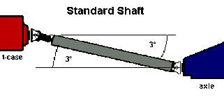

It's hard to fix a vibration problem over the internet but it looks like you have a steeper angle at the TCase than the rear axle yoke.
Those angles should be close to the same.
If the U Joint angles on a drive shaft are not strait (they never are on an off road vehicle) then they actually speed up and slow down on each rotation. This can produce a bad vibration. But a drive shaft is made so the vibration of the front U Joint cancels the vibration of the rear U Joint. This works great if the the angle of the front U Joint to match the rear. This is how every manufacture makes vehicles.
But this only works at small drive line angles. The UJoints don't like too much angle so when you lift your jeep you may have to angle the rear differential upward. This can be done with angled shims at the leaf springs. Then to keep both u Joint angles the same you can lower your TCase. If the drive line angles get to be too much you should then go to double cardan joint or a CV joint at the front of the drive shaft. A double cardan joint is 2 U Joints together.
These 2 U Joints cancel each others vibrations. In that case the U Joint at the differential should not have any angle. To keep it from vibrating it should be strait like this.
Now you can see how the pinion is much higher than the manufacturer intended.

First rule: The front u-joint angle should match the rear u-joint angle (withing 3°). It looks like the front u-joint angle is greater than the rear ujoint angle. To shim the rear axle to make both u-joint angles match you would have to shim the axle down. That is not the normal direction to shim an axle.
This next picture I added a blue line showing the front edge of the yoke. This is what PaRenegade was talking about checking the angle against the yoke. The yoke on the diff is the blue line. You can see the yoke almost points to the drive shaft with very little angle at the drive shaft.
In reality you can't slide against the yoke with the driveshaft in place, but when it's not then you have no shaft to make parallel with.
Second rule: do not icrease either u-joint angle too much. A u-joint at a high angle will experience too much stress and wear. This is why I say you would be better off lowering the TCase to get both angles the same. Better yet install a double cardan joint drive shaft.
