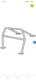

Is this how the roll bar on a 78 cj7 should mount. With the back mount on the rear fender and the front legs on the floor or close to it.
That's not how the factory cage on my wife's 79 is. It's like the op's cage
The 78 roll bar , from the factory, was mounted on the wheel well not the floor behind the seat. That change came in 1979. The problem that I see with your bar is that, for bars from 78, it should stand straight up and down with a small arch in the center, Yours leans back, much the same as the 79s and all that came after. Is there a chance that someone has fabricated a roll bar for your jeep that didn't come in it from the factory? Just sayin, it doesn't look like a 78 bar
Very possible why I was asking figured the top was right and the bar wrong. Cutting and welding is no big deal for me. Just got to see if I want to do it the easy why or hard way.

Shame your not closer to Maryland I could give you a factory 79 bar. I'm not using the one in my wife's Jeep as I'm going to run the family style cage out of a 93-95
you could also see if someone in your area has a bikini top for a 79 or 80 that you could try. Since your bar leans back a bit maybe the newer top would fit your bar
This one said it fit from 76 to 81
They will say anything to sell a product doesn't mean it's true
Well then, maybe one that fits an 81 or newer. There must be a difference in the tops. I wouldn't buy a new one but it might be easier than rehabbing your bar
and I'm sure the way they set changed in79
The one in my wife's 79 looks like his. I'll nab a pic in the morning.
I would try returning it and trying a different top could just be a bad run. If the second one is also not fitting then you start looking at the cage
Ordered this one from Amazon so will be easy to return and going to order a different one directly from besttop and see. If this thing hadn't been such a basket case of a jeep I would have questioned the top before the jeep. But we'll see old girl might have the right bar in her.
Ordered another top from besttop directly and same. So it's the roll bar not the top. Going to move the roll bar forward and fab it in right some pictures of what it should look like would be much appreciated.
