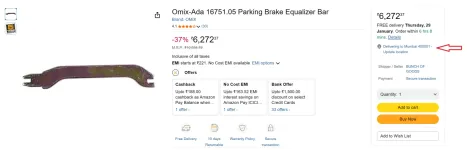

Is that the Omix # 16751.05 or OEM # ‎937966? It appears to be available in Mumbai:
That is a discontinued part number. No wonder the PO made a homemade replacement. Seems if done right from the correct material, should work OK. But also seems any vehicle with 11" drum brakes should have basically the same part. Your choice of a Ford part is probably better than getting one from Mumbai :)
