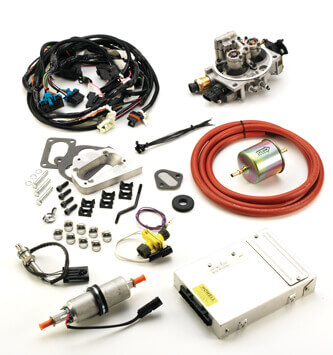

I dislike Howell it's not user friendly and pia to tune. I have here recently installed an Aces system on a guys Mopar. Cost wise it was quite a bit cheaper than the Holley. I'm waiting for tuning and long term drivability before I start to recommend it over the sniper.
This is the kit I installed if anyone is interested in their own research. I don't know if they make anything for the Jeep or not.
