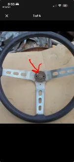

Steering Steering shaft is “off” ; how can I adjust?

At the steering gear box, you can remove the retaining bolt, slide the steering shaft up off the gear box splined shaft, rotate the shaft where you want it, then slide it back onto the gear box shaft and re-install the retaining both. Doing this allows you to rotate the steering shaft to any position, one tooth or spline at a time on the steering box shaft.
