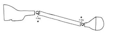

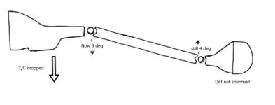

I'd check the pinion bearing and rear output bearing on the T/C. If you lowered the T/C but didn't raise (shimmed) the diff you threw off your driveline angles.
That vibration energy has to be dissipated somewhere, most likely the output bearing. If driven over time it will ruin the bearings and move onto another area. You'll also need to shim the diff to get those angles as small as possible, and the same
