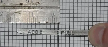

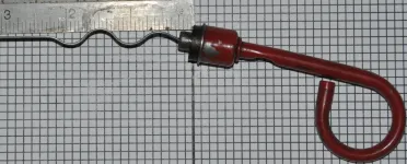

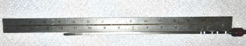

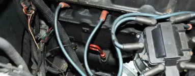

First, the pictures:
Installed Position: between the firewall and distributor, below the valve cover, under cylinder 2
The full length
distance between "full" and "add"
The zig zag portion of the stick, below the handle and above the part number
The part number is 3237515. There is an "M" stamped on it not far from the part number.

The paper grid in each photo is composed of 1/8th inch squares (graph paper). I did this to help the person looking at the pictures figure out about how far things are apart from one another.

My stick - like all other dipsticks I've seen - is bent.
I was tired when I took these photos.
As I was nodding off, I realized I should have used a C-clamp to flatten out the material and I should have looked harder for a decent tape-measure. Looking at the last photo, the spec says 12.46 inches in length, which looks right to my eye.
Anyway, I hope my efforts help.

One more thing: The pictures don't depict the serious arc along the length of the dipstick.
If I'd had pushed it flat, it would have been about 12.5" in total length between the seal at the base of the handle and the tip of the measuring staff.
