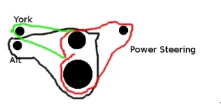

York OBA Question (belt routing)

'84 CJ-7, 258, Sniper EFI, AX15, Dana 300 HD Outputs Twin Stick 4:1, York OBA, D60, D44 Locked F&R
Do a google search for the front of an AMC V8, go with the image option.
The York is a duel pulley system, yep two identical belts running both the Alternator AND the AC pump. Over the AC pump pulley, Over the water pump pulley under the Alternator and back to the AC.
This isnt for a V8, it's for the AMC 258 i6 / 4.2l .
Oops sorry thought I'd seen V8 in there somewhere. The advice about doing a google image search is still valid though. ........... Did they ever have a York compressor on an I6, with the popularity of the York Compressor it seems like they must have.
Quite a bit actually. Now i need to just figure out how to line up the idler and that third pulley.
