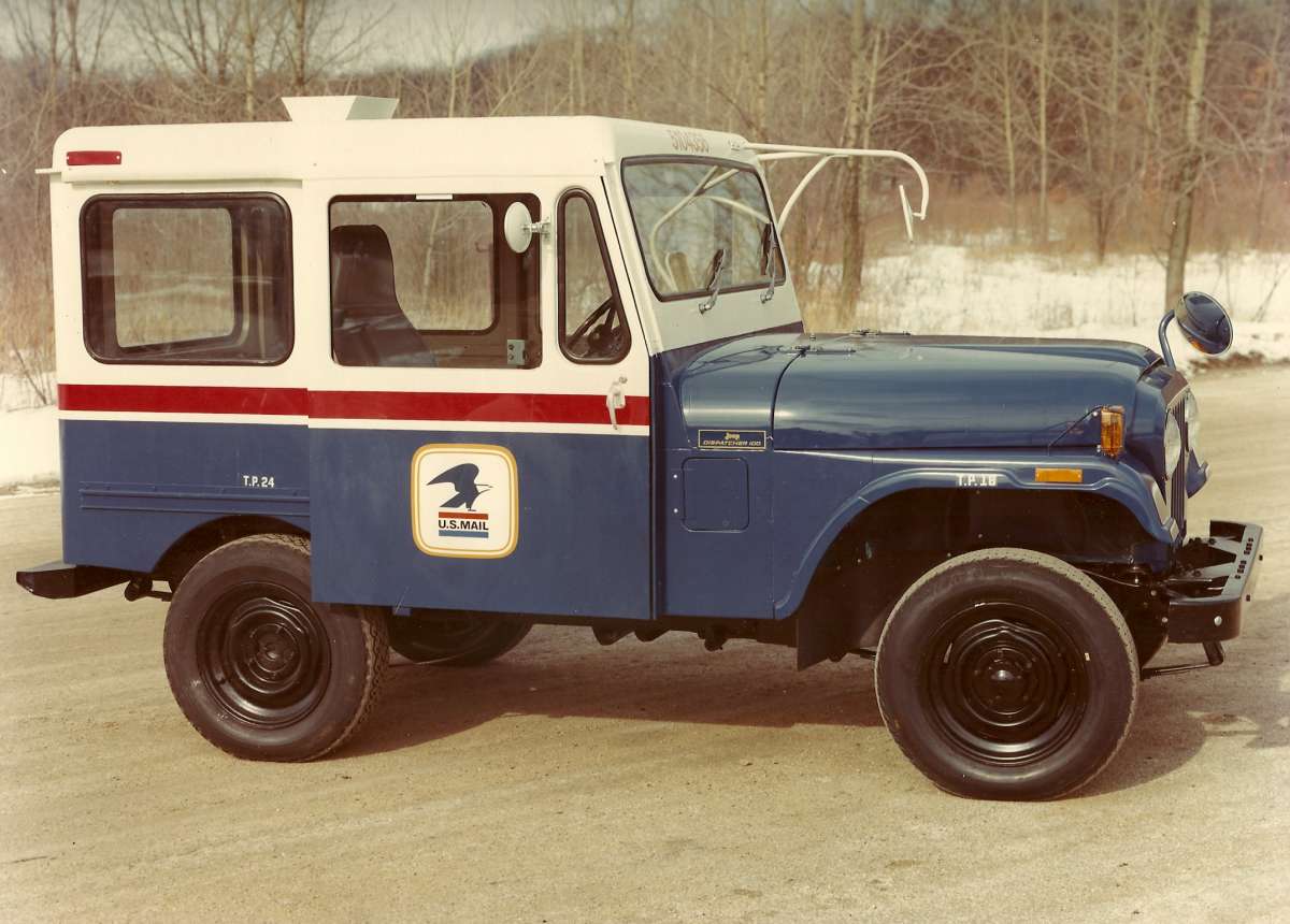

Not a bad idea. If I made the front wider I'd like to make the rear wider as well to match and for stability purposes however not any significant room to widen the rear as the doors just barely clear the tires as-is.
http://www.curbsideclassic.com/wp-content/uploads/2011/06/5453256945_6396185e89_o.jpg
I guess it might work if you used wheels with the right back spacing?
