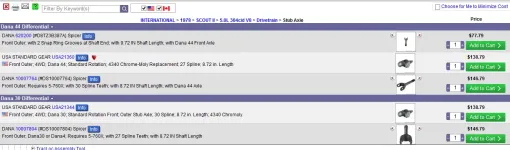

Thanks to a couple of awesome forum members, I recently got a Dana 44 housing that has been narrowed to WT CJ width. I am planning on building this slowly and swapping it in next winter. My plan is to use Scout stub shafts and my existing CJ knuckles, brakes, and steering components. Looking at scout shafts there are different options for lengths, does anyone know which one would be the right one? Also, do I need to stick with 27 spline stub shafts or can I upgrade my hubs and use different stub shafts? I will be running an ARB locker, 3.73's, and 33's. Any advice for this build would be appreciated!

What did you use for sub shafts?
I used the scout Dana 44 stubs. I beleive theyare the same as the Dana 30 that came in my CJ. If not someone will correct me
