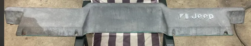

Many people have tried vinyl repair kits without much success. There are also those that swear by JB weld products that are easily applied and sand down well. Making it supple again may be more difficult as it may impede the application of paint. If JB weld on a small section works, use it, paint it and hope it has a long life. Or..... I simply broke down and spent the $200.00 bucks for a new dash. They also have them in the paintable version if you don't want black

yeah, was hoping to apply something to soften it some, something that might soak into the vinyl, dry and be paintable, only paid 50 bucks, plan on a new one in the future
I have used Meguiar's "57" cleaner/restorer. Not magic, but works quite well.

TriNova also makes a good product, but leaves a greasy residue for a few days. So wait to paint over it a week or so.

To fill in cracks/holes, I have used Rub-n-Restore filler.
