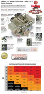

If you go with a carb the Holley Off Road Truck Avenger works well.
That's what I run.
I not a "Extreme" rockcrawler, but a carb is stupid simple & you can fill up anywhere. Even in Mexico, if you balls are big enough.:biggun: :laugh:
