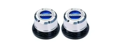

I lost a hub this weekend :p. I was wheeling and when I got back to camp I noticed they were loose. I disengaged, forgot to tighten up and drove home. One was gone by the time I got here.
I had no problems with the Superwinch hubs on there the last 4 years but came across some on the web that said they have nylon centers to get you off the trail if they break. It also said they shouldn't :confused:.

Like you I've had good luck so far (6 years now) with my superwinch hubs.

I ended up going Mile Marker which was up there with Superwinch. Warn seemed to be worst case (for 5 bolt) behind AVM and Rugged Ridge based on my research.
I have to say, I had no problem with Superwinch. The difference seems to be superwinch is a wider lock which means you will not loose it as easy. But most I saw were aluminum. MM seems more solid as the hub part is smaller but can back out and fall off easier as you can reach them with a socket and the lock out will not stop or slow them.
