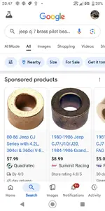

Does anyone know what pilot shaft bearing I will need for the '79 258ci with an '82 T-5 Transmission ? The bore on the back of the crank looks right at between 1.054" and 1.0660". But the pilot shact on the tranny measures way over the 1.125" I see online. Mine is closer to 1.6" measuring with a set of digital calipers.
The only pilot bearing I know is the brass one that presses into the flywheel
Ohhh... I misunderstood. Sorry about that. I missed that on mine because it's already be pressed into the crank bore. Not sure, but that does sound like way too large a diameter.

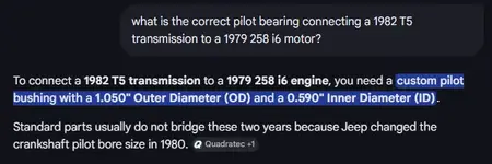

Does anyone know what pilot shaft bearing I will need for the '79 258ci with an '82 T5 transmission? The bore on the back of the crank looks right at between 1.054" and 1.0660". But the pilot shact on the tranny measures way over the 1.125" I see online. Mine is closer to 1.6" measuring with a set of digital calipers.
Make sure you did not miss THIS POST by @Sawjaws as it is the correct answer to your question on what you need to do for a pilot bushing. You need a custom bushing. You can buy a blank bronze bushing and a machine shop can easily and cheaply modify it for you.
