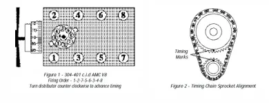

OK - Case solved - I scanned the pages from the factory manual and attached the PDF. The timing marks are aligned at TDC and when rotated 90 the marks are at 3 and 6...
The teeth should be between 20 and 21 when rotated...
So - A summary!
Install mark on cam at 6 and crank at 12. Rotate untill marks are at 3 on cam and 6 on crank. Count the # of teeth and the crankshaft mark should be between 20 and 21... :chug:

No, you need to do the steps outlined in the pdf. Put the cam in at 6 and the crank at 12, then rotate until the cam is at 3 and the crank is at 6, then count the teeth. Then rotate back to 6 and 12 again so you can install the dist correctly.

V-8 timing marks line up CENTER LINE to the camshaft and Crankshaft.

It is scanned from my factory 1972 Jeep manual and it says to count the pins also, after setting it initailly with the marks lined up and then rotated to cam 90 degrees. Some where we have a disconnect, but I believe we are all saying the same thing in the end
