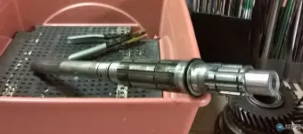

I got the '68 T-18 up on the freight cart and verified the shift pattern it IS and early one (by the shift pattern) but with the somewhat fresh rebuild (except the reverse idler) the conversion may go well.
So far I've removed the shifter, keeping the pin safe in a ziplock, the top cover off and the bearing retainer and first snap ring, went easier on this '68 than on the '80. I hope the bearings are likewise, I brought my two brass drifts and my 5 lb. cross pien hammer and see if I can get 'em to budge.
Unlike the difficulty with the '80 Transmission , using this method the front bearing is already halfway out! :D

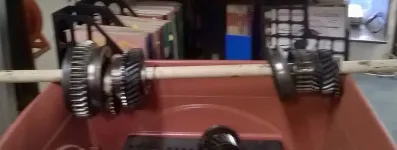

Thanks Bass & Hedgehog. I'm even keeping the 1980 T-18 , just in case. Until this is complete I'm keeping everything in baggies and the gears in order and orientation on the dowel.
Doh! I may have gotten happy too soon plinking away at that front bearing and it seems not to be moving as much. I tried using the 3/4" drift on the bottom of the bearing with a wood cushion just in case it was crabbing out, only the upper side of the bearing is reachable from inside the case, but so far no progress that I can see.
