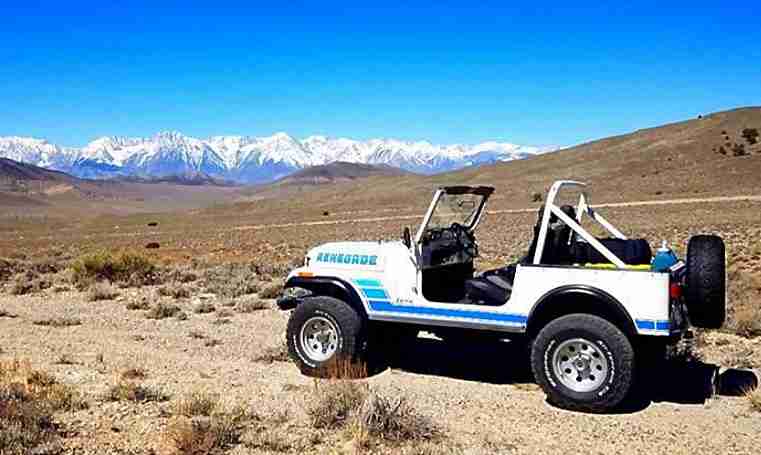

I have a '75 CJ5 with a AMC 258 i6 / 4.2l . The jeep and suspension are stock and I am curious what can be done (if anything) to reduce the extremely rough ride on rocky terrain. I realize these old CJs are old school single axle and don't have the suspension of newer jeeps. But I'm wondering if anyone has had experience with a leaf spring replacement or shock absorber? I have heard that using a Bilstein 5100 shock will improve the ride, however these shocks are expensive and I think the front and rear leaf springs are so stiff that Bilstein shocks may not be much different. Has anyone had the same experience or found improvements for this?
