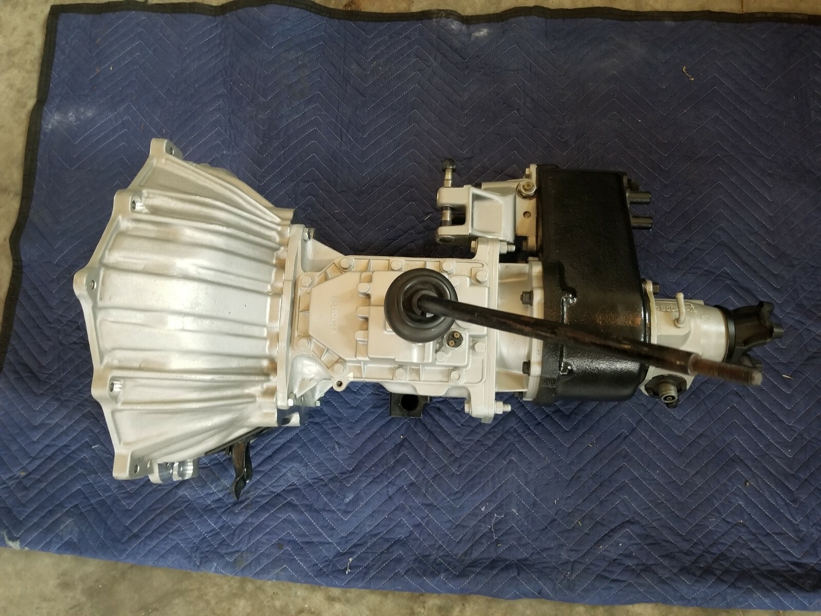

I'm looking at a T-176 and Dana 300 for my '79 CJ5 . They came from an 80-86 CJ7 .
How will I know if they will fit my CJ? I know there were different input shafts on this Transmission . What do I need to know to verify that it will fit my truck?
It was mated to a small block chevy via an Advanced Adapter bell housing.
Thanks for any insight. I might just buy it and take a chance....
If it came from a CJ7 originally it should fit yours. You will have to find the right bellhousing.

I'm assuming you have the stock T-15 3 speed in it right now with a stock AMC engine? The short answer is yes, the bolt pattern in the front of the tranny should fit your bellhousing. Keep in mind that they made two different versions of the Dana 300 Transfer Case : a long rear shaft model for the CJ7 and a short shaft model for the CJ5 . Those are much rare and hard to find. This should bolt into your CJ bu the rear driveshaft is going to have to be quite short and at a steep angle, since you have the long output shaft D-300.
They came in 5's and 7's 80-83 and 80-86
Just a note: if mated with a gm the top 2 ear holes on the T-176 may be elongated.
Depending on what adapter they used the top holes don't line up on some and need to be elongated.

I have the T-150 3-speed now so the 176 should bolt right up just fine from what I've been reading. Really wanted to make sure the input shaft was going to be the right length but like it was stated, if it came from a CJ7 it should go in just fine.
I'm keeping my AMC 258 i6 / 4.2l I6, I like that motor. Currently it's a remanufactured engine so not matching numbers but it's "stock". I will later build that to a Clifford Performance dual Weber engine.
As far as I can tell I should need just a new pilot bushing to bolt everything together. The clutch/pressure plate will be new also.
Also will be doing 4 inch lift spring kit so new driveshafts will be there. Going to use Tom Woods stuff. I've heard his name used with driveshafts so much I can't even imagine that anyone else makes them.

Keep in mind that they made two different versions of the Dana 300 transfer case: a long rear shaft model for the CJ7 and a short shaft model for the CJ5. Those are much rare and hard to find.
Not true.
The short output Dana 300 was used in 1980 only (for both CJ5s and CJ7s & also Scouts). All 81 and later D300s were the long output version.
OP, also, the clutch disc is different for the T-150 and T-176 . OEM skid plates are different. Not sure if you can make your Dana 20 skid work or not. If you can find a T177 with the 3.8 1st gear, that would be a bonus, but I wouldn't pass up a good deal on a 3.5:1 T176 in hopes of finding the 177.

I stand corrected. Thanks for setting me straight. I thought the short shaft Dana 300 came in all of the CJ5 's.

Another question about putting in the T-176 /Dana 300 just came to mind. Will I need to do anything about the shifters? Will they align where the T-150 /Dana 20 holes are?
I'll be doing the twin stick on the D300 too.
