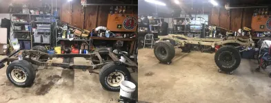

'80 CJ7, Just a rolling frame right now... will have Mopar 360, Torqueflite 727, D20, full size D44, Chrysler 9.25 with 4 wheel discs. SOA on Rubicon Express 1.5" YJ springs.
Making progress, yes.
Looks fantastic - yes!
Makes the rest of us jealous - YES!!
Slow going? - Heck no - your before and after pics are both from the same year..... that beats a lot of us. From where some of us sit your hauling butt..... Looks great so far - KEEP IT UP!!!
