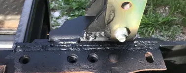

Well, I managed to get the frame to the welder. Of course things did not go as planned. One of his buddies he lets use his shop had left his gas on... no mig. Had to stick weld it. Not as pretty, but should be just as strong. Interesting side note: the work was free. I traded the work for an old welder I was given for helping a friend last year on his project. I don't have 220v in my garage, and don't know how to weld very well anyway... He used his free machine to do my free work.
I bolted the front adapter and the 3/8" spacer to the frame, and he stitched both together, and to the frame.
Then he put the rear pieces together, stitched the side plates to the frame, and added the gussets.
