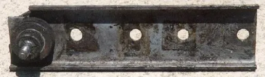

Here are some pictures of the torque stud (aka transmission stabilizer) bracket, stud, and bushings. You can see the bushings to the torque stud on the left side of the bracket picture. When I go to bolt the skid plate back up the weight of the motor/transmission/transfer case is on a jack stand positioned at the back of the motor. I then put the skid plate on a pump jack and jack it up until I can align the holes up including the transmission mount. Once the mount/transmission are loosely bolted together I use longer bolts than normal for the skid plate and get them started. (At this point the skid plate will not be tight to the bottom of the frame) I then will use the pump jack to raise the plate up a little then tighten the bolts a little and adjust as needed to get everything to line up until the skid plate is in place and all is properly tightened.

The torque stud helps with the twisting/slapping on acceleration and deceleration which also helps with the longevity of the mounts. On a 1976 and up CJ the torque stud plate bolts between the top of the mount and the bottom of the transmission. The stud bolts through a hole in the skid plate then the two bushings go on top of and under the large hole in the torque stud plate with the stud holding the bushings in place.
