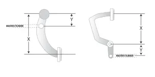

Did you ever check the pedal ratio as I once mentioned?............you went from non-power brakes originally to power now...........non-power pedal ratio is about 6:1 , power ratio is about 4:1..........will that make a huge difference in how aggressively it stops? .....Yes it will.............also the linkage adapter between the firewall and booster can also effect that ratio........

Tarry - Yeah, I know there is all kinds of math that can be applied. But frankly I ain't going to do any of it. I relied on a company that specializes in power brake conversions and this particular one isn't an uncommon one. I do know that there were two brake pedals, one for a power brake and the other for a manual brake. I'm going to see if I can find one for a power brake system. Or at least find out what the difference is between the two.
Hey , No Problem drive it the way it is...........and there was never two Brake Pedals........the difference is where the push rod was located. Some Pedals had two holes , some had the extra hole blocked with a stud for the brake return spring.
The fact still remains:
Pedal Ratio is one of the most overlooked parts of a brake system. One of the main reasons and causes of a hard brake pedal or in your case a sensitive pedal is simply due to incorrect pedal ratio. When a brake pedal gets modified to “fit” in a vehicle or a booster/master cylinder gets installed where it “fits” in the car, the pedal ratio is rarely taken into consideration. Proper pedal ratio is a must when installing and operating a brake system. Below is a diagram to show how to properly figure pedal ratio:
Pedal Ratio = X divided by Y
In a manual brake system, the pedal ratio will be between 5:1 and 6:1 and a power system will be between 4:1 and 5:1.
If the correct pedal ratio is not achieved, the pedal will be extremely sensitive due to too much pressure being applied too quickly.

The math: Yep that looks like math all right...... I do understand how different ratio's effect the way your brake pedal feels.
If the "Y" distance can be found, I'll run with that.
