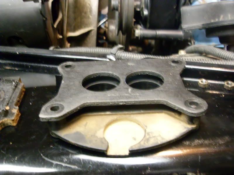

Yup thats just what Id do. Keep it in there and glue it up. There should be a gasket there also to help prevent any leaks. The one on my old AMC 304 was cracked in much the same way and didnt effect it that Im aware of. :)
Ok got it all back together, i went and got the right gasket. It runs ALOT better, but needs a little fine tuning. Guess im going to have to wait till tomorrow to go riding. My headlights nowarent working so time for e new thread. :)
