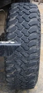

I bought my CJ with 35 inch tires and did a lot of cutting to make them work. I have no fender flairs (not good for muddy areas). the rear fenders have circumference for tires up to about 31 inches. Over that they need trimming (and a lift). If you don't trim you will have to lift it a lot more.
Then I put on 36 inch SuperSwamper SX Bias Ply tires. I was worried about the one extra inch but it was the extra bulge of the Bias ply tires that caused the rubbing.
Before
And here is my new tires
and both sets of tires have the same width.
Yeah, so basically it's going to be trim a little, try it. Trim some more then try it again. Busa the difference is huge! I am just wondering if I should wait to trim until I get a new set of rubber. If I go for a bias ply, the whole game changes it seems to me!
Exactly, I can't even tell you how many times I trimmed my fenders.
Trimming the fenders is up to the owners discretion. I know may CJers cringe when they see my fenders. But no one wants to get carried away. You don't want to cut too much and then find out your new tires will never fit up to where you cut.
