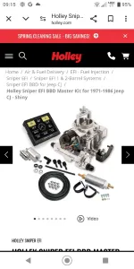

2100 is a fairly simple swap. However the one I posted about should be a direct drop in
