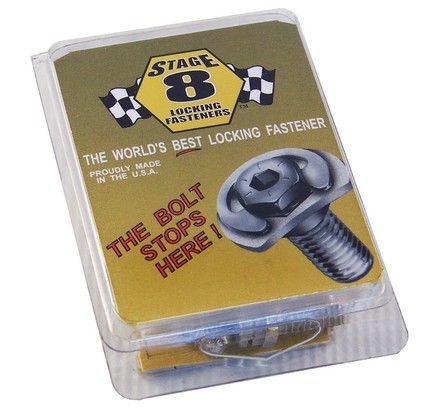

The Carb is already off. Unless you've got a stuck bolt and need to extract the hard work is done IMO. I would pull them, clean up the intake, polish the flat surfaces of both, apply a new gasket, and new header/intake bolts. Not only will it run way better, but your engine compartment will look way better. Who doesn't want that?
Those header bolts are expensive, but they are way better than the OEM bolts, with the round washers, in every way.
