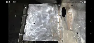

Still playing with the shifter, still playing with the body. I’ve been busy so I didn’t have time to get much done.
