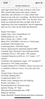

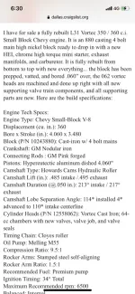

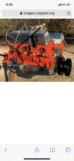

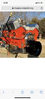

decent motor. older than 90s though as they went away from distributor style and weren't 4 bolt main but that's better for you.
Sent from my E6810 using Tapatalk
You will need a lot more than the engine to get rolling. But that seems like a really great start on a fun ride. I went really old school, and found a 1969 AMC 343 (thought I'd bought the AMC 304 ). I was trying to decide whether to rebuild my I6 AMC 258 i6 / 4.2l because it was a better choice than the 304 UNTIL I cleaned the engine and found that upside down 343 on the engine. Like you, I've decided to have the fun of a small block V8 that can be upgraded. Saw an engine like you found for $3k locally, about 60 miles away from my house. But I've already purchased the Advanced Adapter to mate the Ford T-18 tranny to my Dana 300 . Lots more goin' on with Edelbrock 7531 RPM intake manifold, Edelbrock 1406 4bbl carburetor, headers, etc. Mine has been a slow moving project, collecting a part here and a part there for ten years. Guarantee it won't be slow moving when I get it all assembled and running!
That’s a decent price if all fresh and a solid building point. not a crazy deal, but not over priced either. Lots of info for sbc conversions, but lots of small things add up. But again, it’s a V8 in a CJ!
