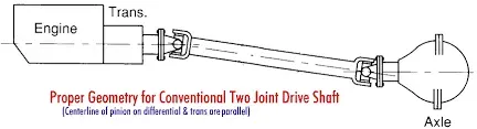

In theory the yoke on the differential should point at the yoke on the TCase. This way the U-joint at the diff will have 0° angle. It should not be angled at all.
Let me explain why. When a U joint is at any angle at all it forces the drive-shaft to speed up and slow down with each rotation.
In the above picture the angle of the front u-joint is the same as the rear u-joint. This is how the jeep and all vehicles with U joints come from the factory. This way as the front u joint tries to speed up and slow down the driveshaft then the rear u joint cancels that rotational vibration since it is at the same angle. These 2 angles must be the same.
A double-cardan joint has 2 u-joints together and these 2 u-joints cancel out eachother's rotational vibration. Therefor the ujoint at the differential should not have any angle or it will cause a rotational vibration.
That's the theory and that's how most builders set up a double cardan joint. In reality Tom Wood and other experts say if there is zero angle at the rear u-joint it wears oddly and the axle pinion should be tilted down about 1°
