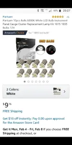

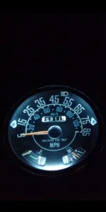

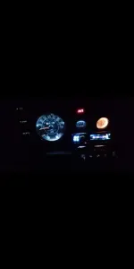

I have. I went led. I'll find the pics of the gauge and the bulbs I used

I did mine in 19 not one issue since and quite easy to do. just make sure you put them in the right way. They will go in either way but only work one way.
And yes they are dimmable
