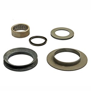

That doesn't look like stupid progress. It looks like a PITA Dana 30 spindle work which all of us know.
