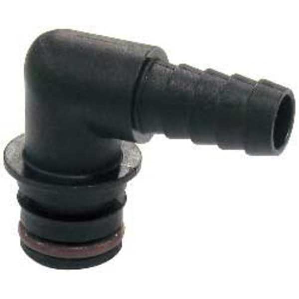

Blowby is normal with a AMC 258 i6 / 4.2l with 90k mile on it. Nothing alarming. A solution to the oil drips from the press-in breather is to get rid of the press-in breather. Instead, use a 90d elbow press-in fitting there at the valve cover and plumb a hose going to the underside of the air filter assembly. This is assuming that rear hose connection I see in the picture (a bit blurry) is your PCV valve with a hose connection to a vacuum port at the carb?
Your air filter assembly may or may not already have a connection for a hose. If not, you can make one fairly easily in a number of ways.
